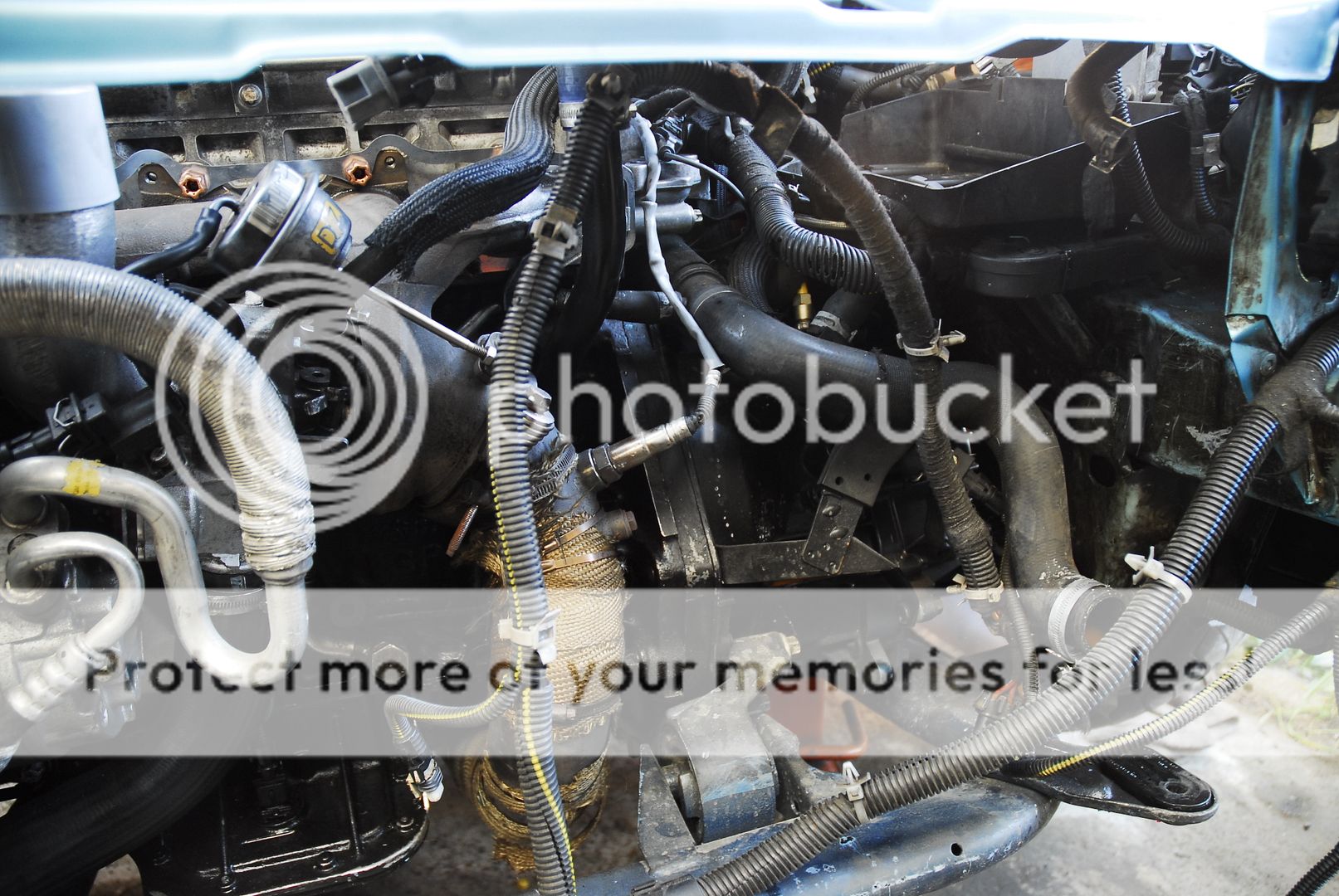

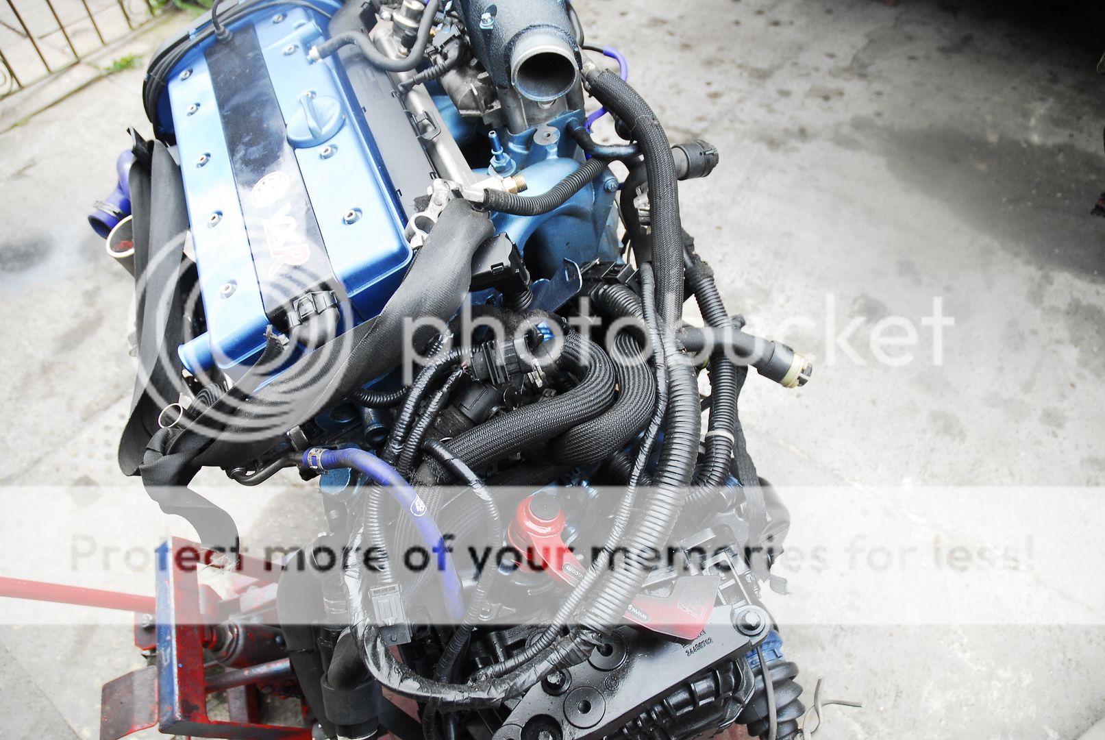

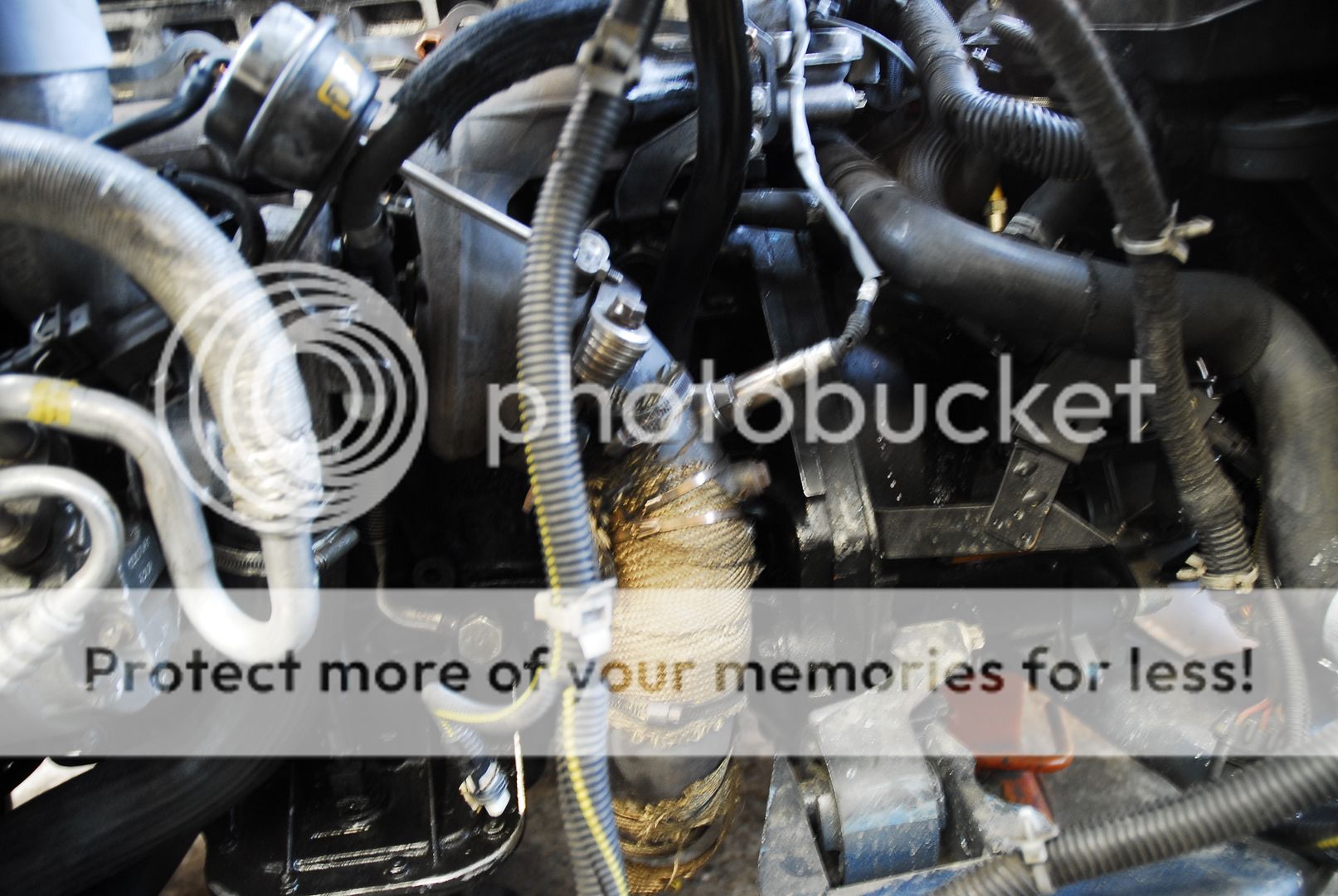

Hi Bob , I'm familiar with your z20leh transplant,
Question please, did you leave the auxiliary pump in place?
This would have had to be a retrofit, as you will know, the layout of comparison water pipes slightly differ, ,
I will recognise your pipe layout from pictures.
I wish to help and advise if I can
B
#17 · (Edited)
Hi,
I will get some pictures tomorrow.
I dont think I have an auxiliary pump. Does it come on the LET or the LEH?
Also what does the aux pump do? Is it required?
Bob
