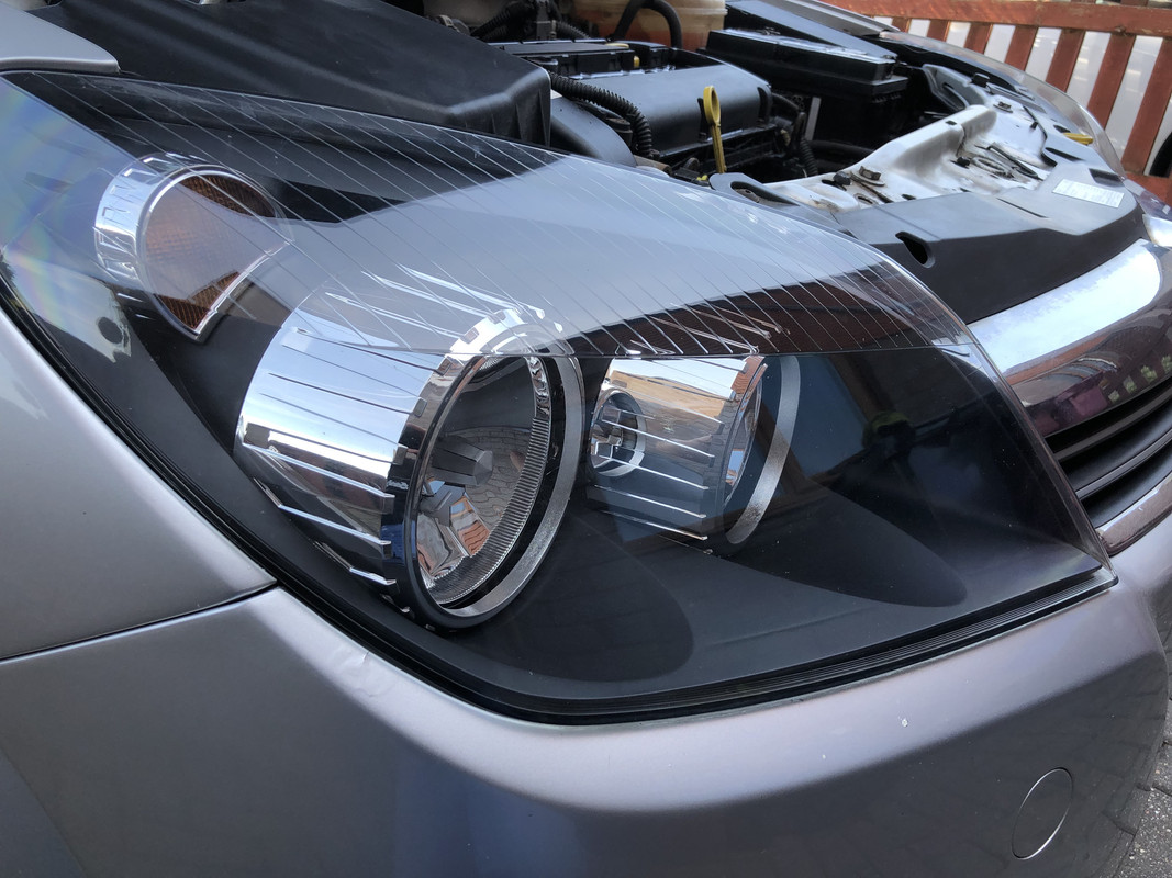

Headlights sanded down with Wet/Dry. Then mopped for about 15mins each.

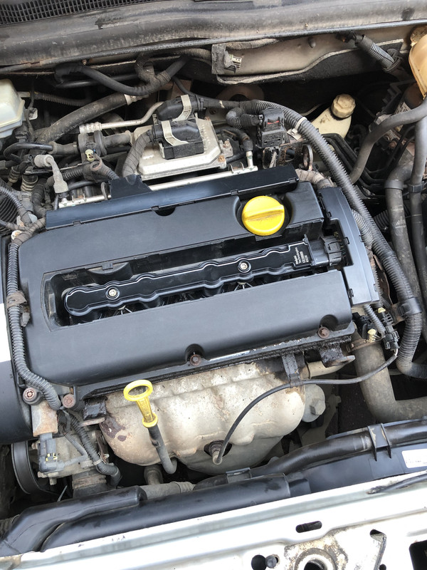

Got off to a bad start as it would seem someone previously had snapped 2 bolts on the cam cover and they are integrated, so i could not change the gasket for now.
New cover on order. Luckily they are dirt cheap.
It had a K&N air filter fitted that i was not aware off, and the restrictor was still present in the air box. So Restrictor removed and new paper filter fitted.

Cold engine. But irrelevant anyway as they are already snapped. You can see in the picture with the air filter.
