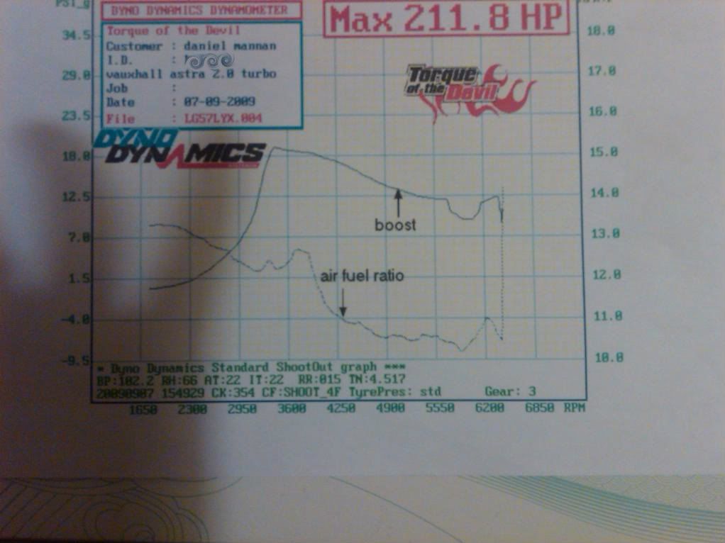

, took it for a spin and OMG, 140bhp to 250 i was in love the hard work had paid off. I had it dynoed within a few weeks just to make sure fueling etc and everything was OK Made 252 BHP and i think 280/312lbs ft torque. Which was pretty much spot on as i had the remus.
Boost and A/R wasnt the best, the boost wasnt holding either.

After it was all fitted i took a trip to REDDOT, where i made 299BHP and 376lbs ft torque. torque peak was around 3500rpms so was an aggresive map to say the least, had to fight with the steerin wheel.
The boost and A/R line was a llot flatter.
