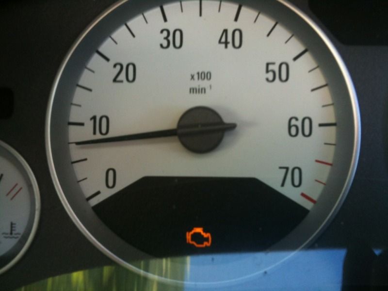

This light came up on the dash last night, car still seems to drive OK tho...
I've tried to find out on-line what its for and cant find a definitive answer, although I'm led to believe that its to do with the Lambda sensor?
I've done the pedal test, but that still comes up with the code for the crank sensor, which I've fixed (I just haven't cleared the codes yet)
have left the battery off when i got to work this morning, so will try the pedal test again at lunch..
If it is the lambda sensor, am i right in thinking that the zlet has 2?
cheers guys!
