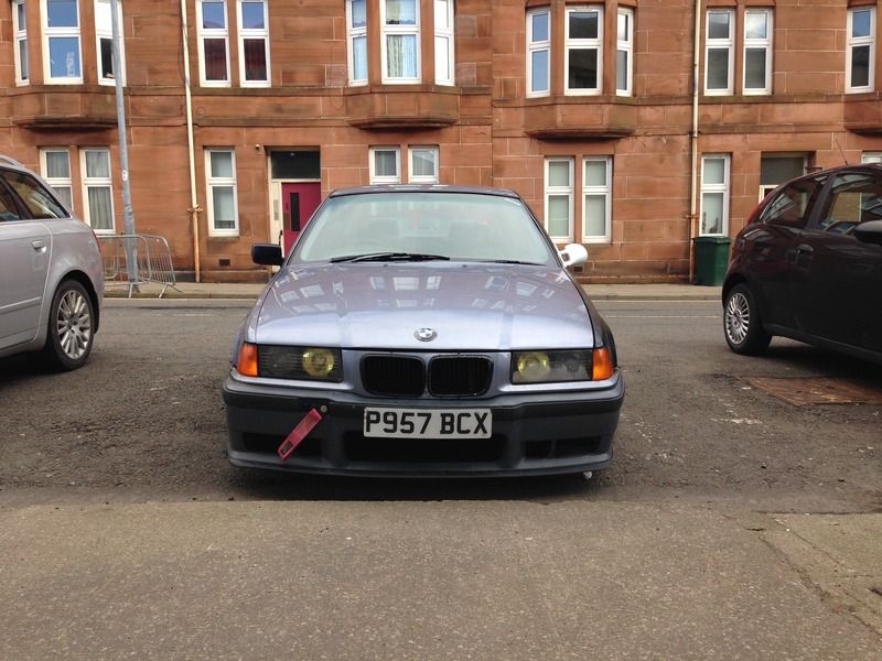

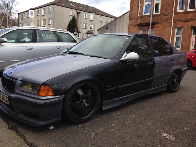

As many of you may know, I've been into drifting for a while and for a long time wanted my own drift car. Last week, one popped up for sale, almost fully ready to go, just some small jobs to sort.

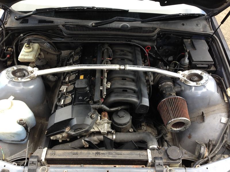

Shes a '97 323i saloon, in a fairly unusual colour, Samoablau and is complete with black nearside wing and door. She has an M52B28 engine with an M50 manifold, pink injectors, remap, backbox delete and a 7200rpm rev limit.
Chassis has a set of TA Technics coilovers, poly bushed front ARB, front strut brace, welded diff and hydraulic handbrake.
It it has an M3 front bumper and lip, some sideskirts, all held together with zip ties.
Here's the pics :D

323? M52B28? :sus: Has it had an engine swap or is it a 328?
Looking good, careful of the E36/E46 Owners Club on Facebook, they can be a great laugh but extremely unforgiving :lol:
Thanks Mike, yeah it's had an engine swap, I honestly can't get over just how ******* quick it is :lol:

Cool, I was gonna say I was sure the 36 had an M52B25 like my M52TUB25 in the 323's. Any idea what sort of power its pushing? I've been tempted since day one to get an M50 manifold swap done on mine but I'm still unsure whether to do it or not.
I've only just noticed it had one M3 wing mirror and one standard wing mirror as well :lol:
It should be around 225bhp, it's the throttle response that surprised me the most, I guess I'd gotten used to the lazy power of the Merc :lol: I'll be getting a replacement for the M3 mirror, then I'll wrap them both, Arctic camo I think.
